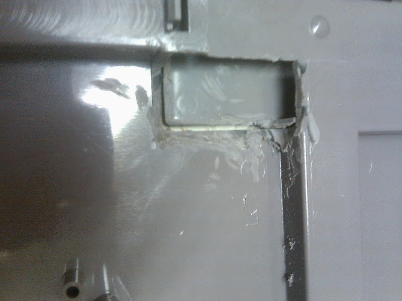

I chose this spot for a couple reasons, I didn't have to cut any pylons to get it to fit, and from the outside, you'd never known I had cut it! If you cut any of those other ridges, it makes a big old hole in the bottom of the NES box.
If you remove the expansion box cover on the bottom, you can see the hole from the bottom of the NES

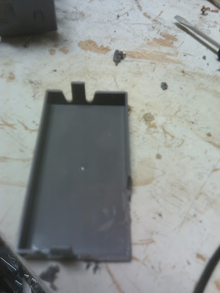

Incidentally, I also had to cut the expansion port cover shown here
https://lh4.googleusercontent.com/-dMBWgt1K0L8/TtB6kw5mVII/AAAAAAAAAlw/Wf6YfxsfA_E/s576/IMG_20111125_203750.jpg

Yay, my panel mount HDMI cable arrived today!
A quick stop with the old dremel and drill and here it is!
https://lh5.googleusercontent.com/-pnt-D-YpqvI/TtbTVdIPB6I/AAAAAAAAAo0/-YMoIvxj0do/s720/IMG_20111130_185122.jpg
Here it is from the top with my print out of the r-pi
https://lh4.googleusercontent.com/-v5RBOWPhdiU/TtbTVQCZUiI/AAAAAAAAAo4/9Pyx4Cy9D60/s720/IMG_20111130_185103.jpg
This was a fairly straight forward part of the mod, I made my measurements and stuck it in. As you can see, I went with the back right (when looking at it from behind) part of the case just to the right of one of the ridges. It was a bit tricky to get the inner dimensions to line up with the outer dimensions (in fact you can see that I actually put my first drill holes just slightly too far to the left). But all in all, a nice look.
I have noticed one little problem. The cable is really stiff, not a lot of flex to it. This might create a problem for me when I go to plug the hdmi in. My thought at this point is to buy two right angle adapters for the hdmi. The first will bring it out of the r-pi and go up, I'll have to make a cut out in the metal shield on the NES (no biggie), then I'll put a right angle on that bringing the it from an upward angle to a pointing to the back angle (so a 180 twist) this will also allow me to put all the excess cable in the metal shield part... or something like that. I'm rapid hitting the point where I need the r-pi itself to get everything nailed down... I think all i have left that I need to do is to mount the ethernet and *maybe* a usb as well

by abishur » Sat Dec 03, 2011 2:05 am
Adding the ethernet
I added the ethernet to the NES. This one was a little bit easier to place. I put it to the right of the HDMI port as you'll can see.
https://lh3.googleusercontent.com/-bvc4JlMe5kg/TtlQJ6fwVUI/AAAAAAAAApY/dRORM2tYAss/s720/IMG_20111202_153119.jpg
This was a little easier to put in then the HDMI was. The metal part on the front comes off and I was able to use it as a guide for the screw holes and the big hole for the ethernet port. As you can see it's actually designed to be able to access a jack like a mic jack, but it will work just as well for a regular ethernet cable.
Here's a view from the top with a test cord plugged in.
https://lh3.googleusercontent.com/-e000qr5jw8U/TtlQJkB4BeI/AAAAAAAAApQ/nvl4gw3HUvo/s576/IMG_20111202_153105.jpg
Now as you can see, it was a bit of a tight fit with the cable in there, and the plug actually point down which makes it hard to remove. I may flip it upside down to fix that issue.
The HDMI cable is still looking like it's going to be an issue, I'll just have play around once I get the board... just a little bit longer, just a littler bit longer, breath in, breath out.
I'm also noticing that once I get things put in here things are getting a little more packed than I had expected. I'm already planning to not put the metal shield on that covers the bottom of the board, I might put some card stock there just to make sure there's a barrier between the NES board, we'll see.
I'm also thinking about removing the expansion port, but only if there's no space for the HDMI cable. The expansion port isn't used for any American games. But I'd prefer to get away without major revisions to the board.
I did decide to go ahead and add a usb mount to the outside (I don't think all my usb items will fit in there and it would be nice to be able to access the ps2 wireless cards as sometimes you need to hit the front of them to get them to sync up). So I've ordered those and I'll post when I get them.
One final thing, I showed the image I plan to put on the outside of the NES, but it's a fairly tight fit so I was thinking about making it much larger and putting it on the top of the NES. Thoughts?
