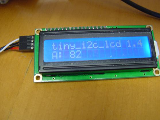

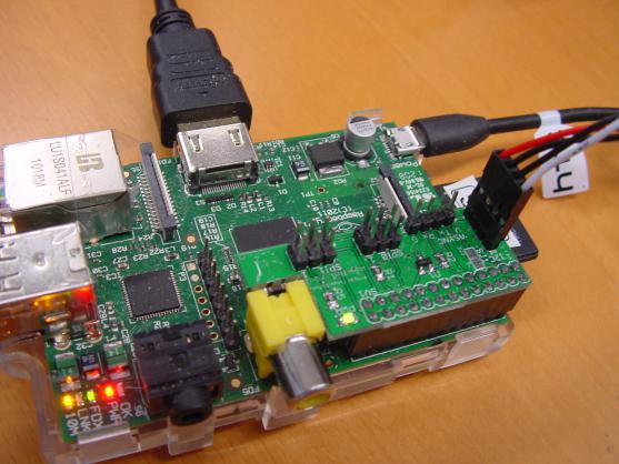

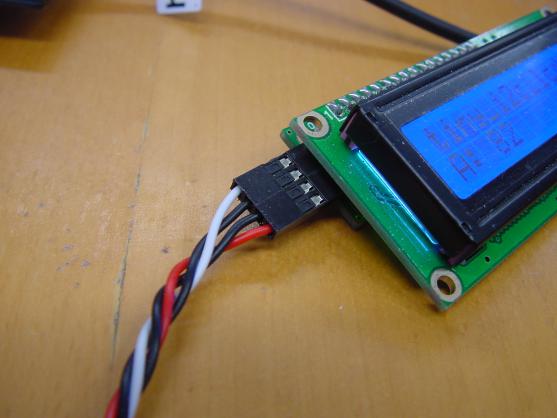

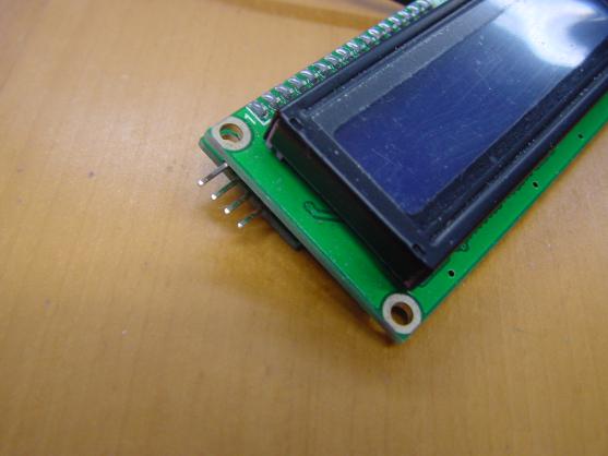

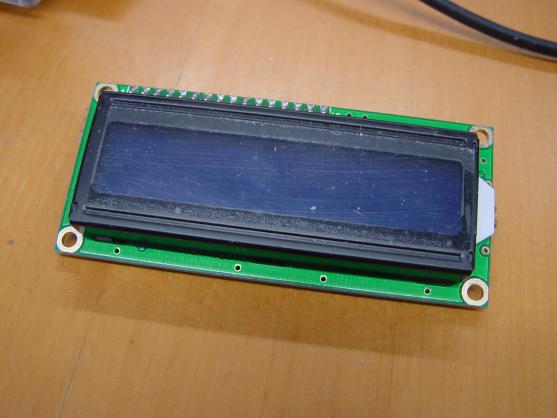

Hello, I'm still not getting the i2c display to work.
I connected the expansion board to the LCD by using 4 female to female jumper leads. It wasn't clear which order the 4 should go in on the screen, so I tried both - one direction the screen lit up, the other the Raspi shut down, so I guess the first one was correct!
The screen is lit and showing 'tiny_i2c_lcd 1.4 A:00'
I'm using arch linux, so I downloaded the i2c-tools package from here http://www.lm-sensors.org/wiki/I2CTools and did 'make' and 'make install' as root (docs say configure is not required).
I then downloaded the file linked in the docs above http://www.bitwizard.nl/software/bw_rpi ... 120616.tgz, unpacked and ran 'make' and 'make install' again as root.
I then tried running commands like './clrdisplay' and './writedisplay hello'. At the terminal I get hex codes returned, no errors, but the LCD screen does nothing - just stays showing the 'tiny_i2c_lcd 1.4 A:00'.
Any ideas what I've missed? Thanks
- Posts: 13
- Joined: Tue May 15, 2012 12:07 pm
As far as I know, they REALLY shouldn't be connected the wrong way around....
However.... It seems that your has survived.
There is one little thing: It seems that its address in the eeprom has been cleared.. The tools assume address 0x82 for the LCD, and yours is now living at address 0x00.
So... Try:
send_i2c 0 0 41 42 43
and hope that you get to see ABC in the top left corner of your screen.
Next, we're going to put the display back at address 0x82.
send_i2c 0 f0 82
and then powercycle the display to see if it sticks....

Check out our raspberry pi addons: http://www.bitwizard.nl/catalog/
Thankyou, that works perfectly!

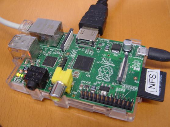

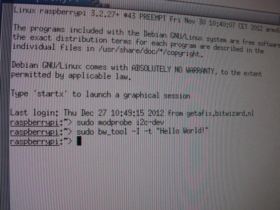

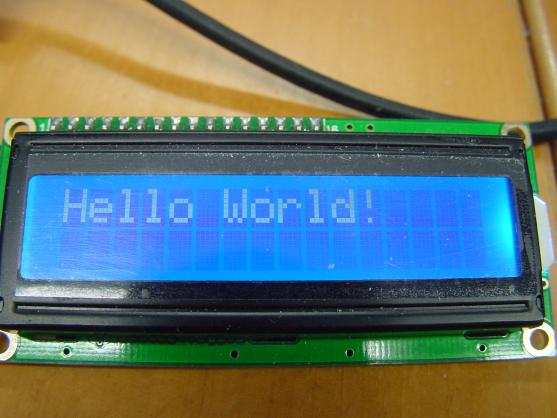

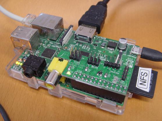

rew wrote:If you have the BitWizard I2C LCD, then here is het picture-howto.
I hope I have taken enough pictures to make any text redundant...
Let me know how you get on.
Hi!
Thank you, this is great! Although the breakoutboard I have received looks a bit different then yours (my has all the pins horizontal, 3 rows at the top, 1 at the bottom - while yours has 1 row of pins vertical and the rest horizontal) , are there any changes from the versions?
- Posts: 6
- Joined: Wed Dec 26, 2012 4:10 pm
The one you have was designed before we got our hands on a raspberry pi. Once we did manage to get one, we decided that some people might like to keep the breakout board within the physical dimensions of the raspberry pi. On the one I have in the pictures, we made the mistake to make a cutout of 8mm for the TV connector, while I should have "kept 8mm of the PCB". Manual sawing to get it to fit.
Anyway, all the connectors have remained exactly the same. So you'd need to find the I2C connector on your board, and use that. The orientation is important too.
Here is a picture that shows the one you have.
http://www.bitwizard.nl/wiki/index.php/ ... _Pi_Serial
The I2C connector is the one on the bottom right, as oriented in the picture. The red, power line would go on the left.
My cable has white, black black red. Normally black would be ground, red power, and anything else signals. So I'd have preferred the cable to be black white white red. However we're not big enough (yet) to have them make custom cables for us that remain in an attractive price bracket. So, I'm using the RED side of my cable for the POWER connection (pin 4).
