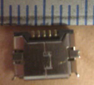

I've just got a micro USB socket for my dummy load — so about the same as a micro USB plug to make up a cable.
The pins are a bit small and close together
Yes, those are millimetres. Fortunately we only need to connect the outer pins.
I've got three 'silly scopes. Now that is silly.
Yes, those are millimetres. Fortunately we only need to connect the outer pins.I've got three 'silly scopes. Now that is silly.
