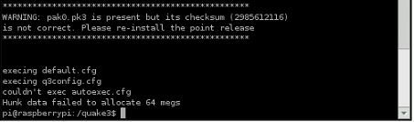

OK, thanks guys - making progress. I'm now getting the following error messages:
Shazam!! It works!! I was running it from a Terminal from the GUI. Rebooted and ran it directly and it works perfectly!
Now comes the sad realisation that as I haven't played a game like this in 10 year I'm absolutely sh*t at it!! My first 10 games lasted about a minute in total!!
Thanks for the help guys!
