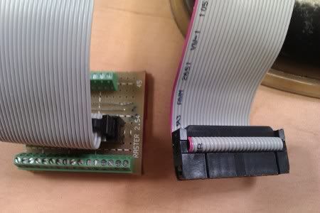

This is a page on how to build a screw connector break out board. Cable fitting, with or without GPIO pin protection.
http://www.thebox.myzen.co.uk/Raspberry/Breakout.html
There is also a lengthy video on how to make the surface mount version of the protection. There is a no protection version as well as a through hole component version. All built on veroboard. There is a downloadable pack of larger layout images and a text file of links to components used from Farnell or Rapid On Line.
Edit by Abishur: Fixed URL
Screw Connector Breakout Board

I do love your idea of soldering a 26 pin connector to the back of a stripboard. A ready made buffer board would be excellent for education.

It is not absolutely necessary to do that much soldering and cutting.
You can get screw terminals in 0.1 inch versions, and some types (although not the cheap ones) of vero board have cuts suitable for mounting the socket already in place. (In the one above I was too stingy to have 13 terminals on each side, which requires different sizes of terminals and they come in bags of 5, so there are some links.)
However you wont have any level shifting or protection of course, and you will have to file down a screwdriver; those screws are tiny.
Suitable terminals would be these, and suitable Veroboard would be this with the useful part extracted by hacksaw. One purchase would make several boards.

Can you make the holes for the SMD components with a stripboard spot face cutter or are the holes going to be too big. I can forsee lots of cut fingers with inexperienced people using scalpels.
Also could I use a Stanley knife instead of a scalpel.

A spot face cutter does take too much copper away. Also I find it leaves very fine shorts that have to be removed by a knife anyway.
The larger Stanley knife is a bit clumsy but the type with retractable blades would do, but a scalpel is a lot better, finer point and much sharper. Non Slip mats are a good idea.
