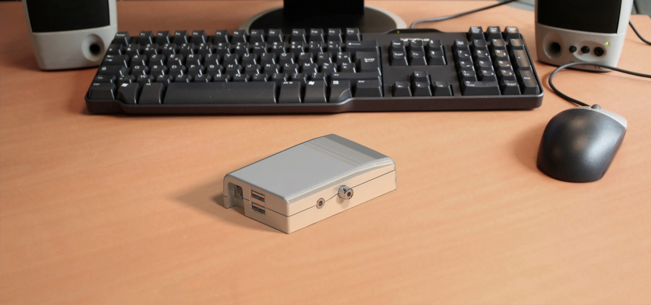

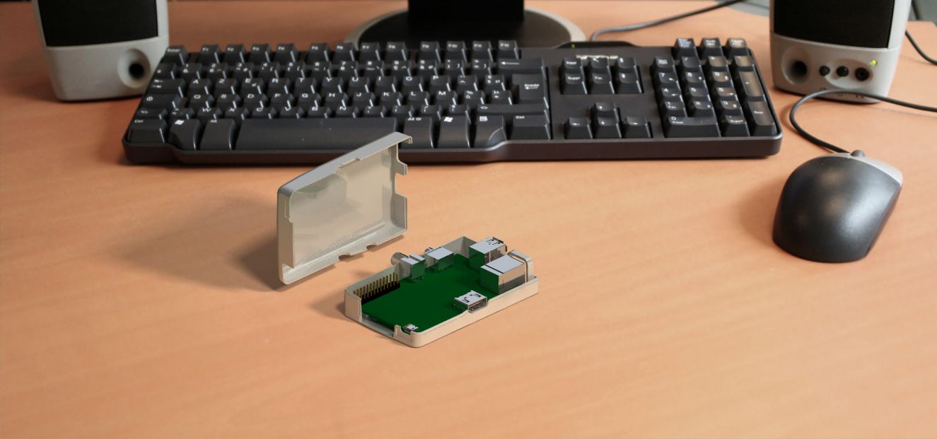

I'm also working on a case for the rpi.
I made the design so that everything is included into the case. the case fits to the usb but still the network connection is available.
It's not done yet. I still need to add the fixing of the upper and top part.
I want to do this by clicking on one side and use a kind of screw on the other(usb) side.
Since I made the case a bit bigger there is room for this fixing.
The compleet case is also prepaired for tooling. So manufacturing cost should be low.
hope you like it.
I added a few picture of the current status.
