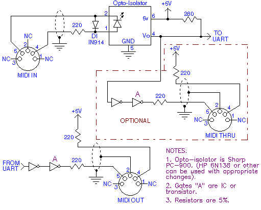

A "proper" MIDI connection (I mean the 5-pin din variety) is a 5mA current loop with an opto isolator between keyboard and UART / microcontroller / Pi, etc:
Bear in mind that the image shows a 5V application. :)

The actual interface as shown here is readily adaptable for 3V3 use, but is the PI able to generate the 31.25 KBPs baudrate? That is the bigger question IMHO.

Okay then, I suppose that using the UART for a MIDI port would be quite easy.
To drive the LED of the transmit opto coupler would take just a transistor and a resistor, and interfacing the photo transistor of the receiver would be even easier, the only complication would be when you want to echo the MIDI in to MIDI loop-through, but that would also be solvable with just a few transistors and resistors.
The rest is just software.

There is no opto-coupler on the transmit, only on the receive. See the schematic above showing how to do in/thru/out.

Neil wrote:There is no opto-coupler on the transmit, only on the receive. See the schematic above showing how to do in/thru/out.
Sorry was being a bit obtuse here, I meant the optocoupler in the receiver of the other MIDI device that this MIDI unit is sending current to. Calling it the "Transmit opto coupler" is indeed a bit strange.
So the PI, with the help of a simple transistor outputs a current that lights up the LED of the optocoupler in the receiver of the other MIDI device, its that optocoupler that I'm talking about, not the one built into this interface.

Ok, yes, you just need two transistors (one to invert, one to drive), or you could use a 7404 hex inverter (less soldering :D ). You need to invert because the UART idles high (+V) and MIDI idles low (no current). Again, check the schematic posted by Gritz or the one on the MIDI.org website:

Problem with a TTL inverters is that either you power them with 5V, and get problems with level conversion thrown in, or you need an inverter that works on 3V3, but have to adjust the resistors for a lower output voltage. But yes, in principle that is what should work.
