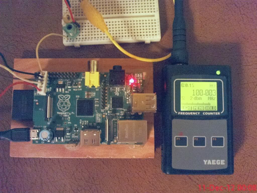

Okay ignore my previous post I had the antenna connected to the wrong GPIO pin.
I think this circuit exhibits some harmonic distortion my frequency counter was showing 300MHz to start with until I constructed a simple RF filter using an S18 toko coil and capacitor.
I wonder if the code could be modified to produce PSK encoded signals??
Richard S.
Richard S.

I set the frequency output to 99MHz as stated in the documentation using the value of 0x50CF (just how this equates to 5.050505 decimal I'm still a little bit puzzled).
Sadly the results were very disappointing, while it did in fact transmit on 99MHz there was massive harmonic distortion throughout the FM / Airband: (79, 84, 89, 94, 99, 104, 107.5, 109, 114, 119, 124.1, 129.1)MHz
For some reason the PI seems to work best at 100MHz with very little harmonic distortion unfortunately this classes with Classic FM already transmitting on 100.1MHz
I'm going to experiment with different frequencies and see which works best I’m not happy that the PI could leak audio broadcasts into the FM Airband region.
Richard S.
Richard S.
