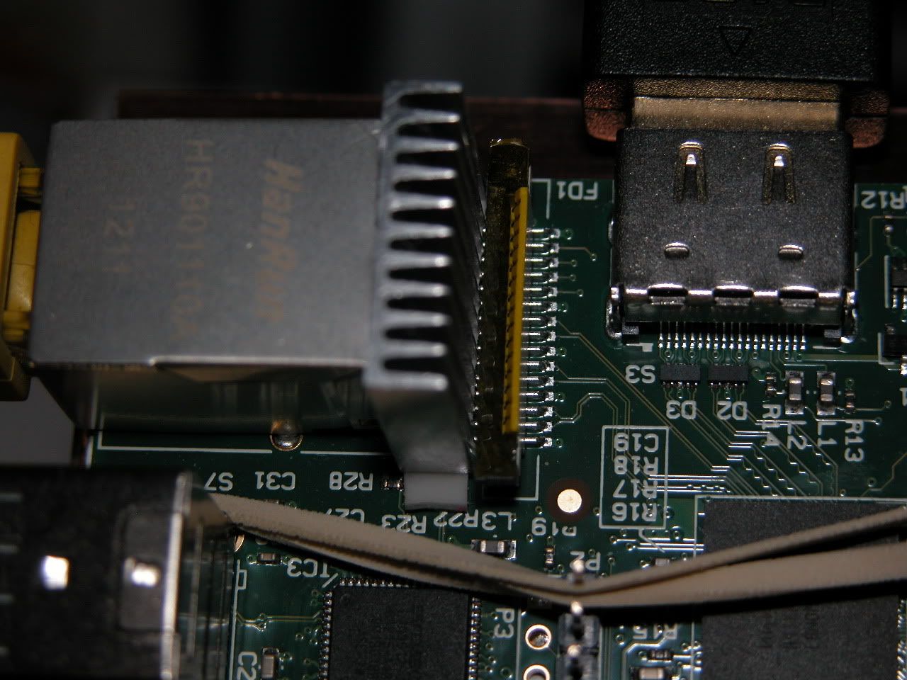

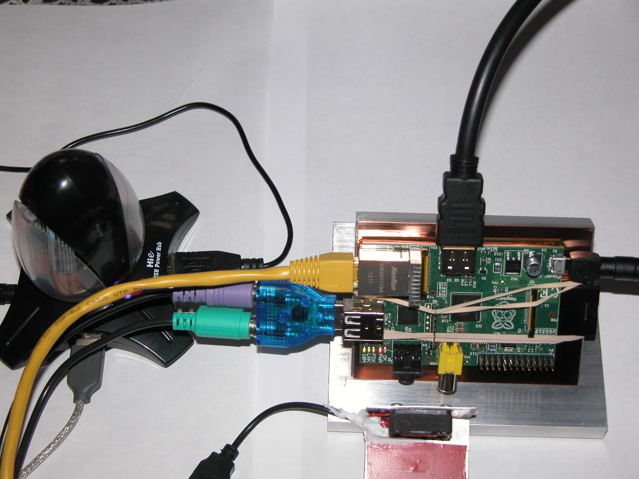

Hi. Sorry to butt in. Completely independently of this and similar threads I found a hot spot around the 6 tiny components near the RJ45 socket.
My solution:-
Pic 1 my "case", with 2 x 2mm (details elsewhere) thermal gap filler*
Pic 2 the "case" upgraded with a 1mm copper plate and the RJ45 heatsink
Pic 3 a close-up of the RJ45 heatsink & gap filler.
Some details. All made from stuff I had lying around, no special measurements were taken. The heatsink is half of a de-anodised (was black) Maplin micro sink. There is a 1mm strip of thermal gap filler covering the 6 tiny onboard components - and the solder pads of the nearby takeoff socket to avoid shorting out on the heatsink. The heatsink squashed down onto the onboard components then stuck to the RJ45 socket using Sekisui #5760 - it won't move.
Using the little 25mm x 10mm USB-powered fan (see Pic 2) the temperatures are now only exceeded by the two main chips which thanks to the little fan show only 2 or 3 degrees above ambient.
Job's a good 'un.
Ray
(*Excuse the killer mounting system - two rubber bands - which keep the 'board pressed down firmly onto the 2 x 2mm gap filler ... must spend some time on this soon!
My solution:-
Job's a good 'un.
Ray
Interesting mounting project! I don't think that amount of cooling is needed, but it looks cool nonetheless
. The tiny components near RJ-45 socket might be the 50 ohm ethernet terminating load resistors R22, R23, R24, R28. They will dissipate some heat whenever the network is active. 100baseT Ethernet uses +/- 1 V for signalling, but those resistors are connected to +3.3V. If there is 2.3 V across a 50 ohm resistor, that is P = V^2/R = 100 mW per resistor. Maybe only half that, if you have a 50% duty cycle, or 50 mW. That is almost the limit for a standard 0402 size resistor (63 mW) so I expect it would get hot.
A heatsink system is unnecessary for the Pi... just set your sysctl.conf right and you won't have any problems.

Hehe - the fundamental idea for the "case" was that I got fed up of the RPi wobbling about if I sneezed - now it doesn't.
Heatsoak through the 'board (any board) has been around since the year dot. Now there's none.
I could be wrong but as I understand passive, non-logic components like resistors, sockets, VRMs etc etc they aren't directly controlled by software. In my standard version of /etc/sysctl.conf - which has three executable lines, two appear to be RPi-specific (swappiness & free_kbytes) - I can't see anything to help cool off the RJ45 socket/ethernet terminating load resistors

I wanted to add an unexpected result I got when I was trying to setup a small fan to cool my raspi.
My usb/eth chips has always ran raging hot, by raging hot I mean you couldn't keep your finger on it for more than a minute. With Raspbian it ran even hotter than with Squeeze. So rather than pasting a heat sink on it I thought I'd setup a way to run a small fan on my board to keep it cool. The fans I have are all 12v and I no longer have any bench supplies so I thought I'd setup a pc power supply and get 5v for the pi, 12v for a fan and projects plus I have 3.3v and -12v available too.
So I took a pc power supply (one that has SATA power cables) and built a circuit board to bring all the voltages to a terminal strip so that I'd have easy access to connect circuits. I'm running my raspi off the 5v from the power supply which is rated for 11A and had a small fan running off the 12v rail.
Voltage at TP1 and TP2 is sitting at 5.1 v and is solid. I'd reach over and touch the chip and noticed it was really cool to the touch. I didn't expect just a fan to make that big of a difference so I unplugged the fan. Without the fan the chip does heat up a little bit, but a noticeable difference when I was running off a phone charger.
That chip has never stayed this cool with an eth cable attached. I have a browser open and have been surfing the net for a couple hours now and I also have a vnc session open to the raspi on my linux box.
This tells me that having a really good power supply makes a difference to how cool the Raspi runs. By good I mean not just one that stays at the suggested voltage when running. My phone charger stayed at 4.9 from start up, but it only had a 700mA rating.
I'm not suggesting everyone run out and hook up a pc power supply, but using this setup and not a phone charger has made a noticeable difference.
Now I need a 7.5v regulator circuit to run this junk Usb Hub.
