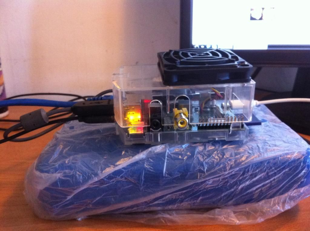

My solution. At least its stable but I have to replace the ice brick every hour or less.
Just a bit disappointed after 3 months wait. Using a 3200mA PSU and got 4.83V across TP1/TP2.
Tried several PSUs, hubs etc.
I bridged the polyfuse F3 to take that out of the equation. Its an RS revision 2 board.
I wont return it as I'm in Australia and I had poor communication from RS. It was too hard to get my hands on to start with.
I have ordered two more from au.element14 with a two week wait this time.
Hopefully I'll get one that works at room temperature and then I'll consider doing something nasty with this one - like reflowing it the kitchen oven
