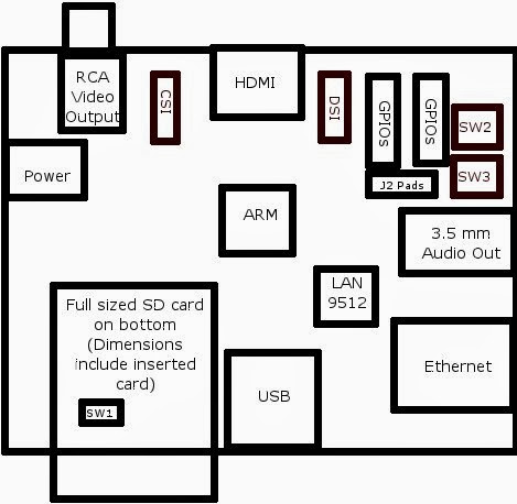

by Michael » Mon Aug 29, 2011 8:59 am
EddieG: That's correct: the SoC has hdmi and composite outputs but no built-in S-Video or VGA capability.
The nearest thing we have to a block diagram at the moment is this from abishur:
https://lh4.googleusercontent.com/-kS2971V7gJ0/TkrfCY6svZI/AAAAAAAAAig/d3KH-BBuzik/Alpha%252520Board.jpg
