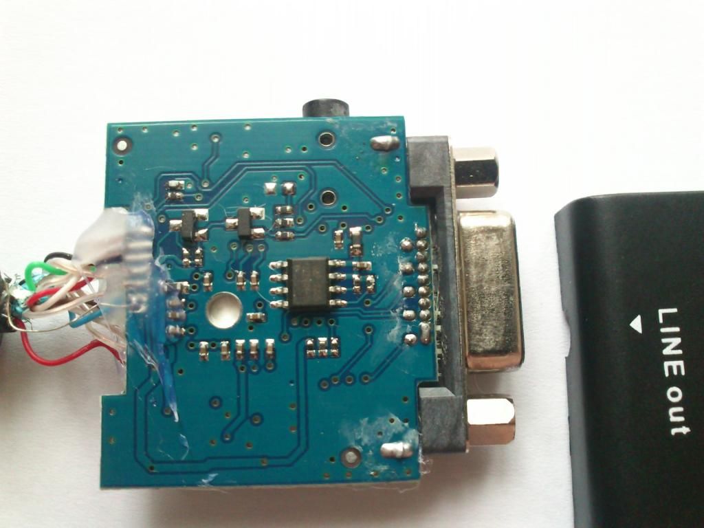

by pwinwood » Sun Jul 08, 2012 10:09 am
Hello mad-hatter,
You asked: How did you break out the 5V line, an adapter of some sort and strip the cable?
I took the HDMI converter apart - this was quite easy, with gentle pressure on the HDMI lead and it's bush in the case the circuit board pops out the other side still attached to the VGA connector.
I measured continuity from the 5v feed on the HDMI plug to pins on the TD6810 switch mode regulator chips on the converter board. I then found a large pad on the underside of the circuit board that was was also part of the 5v distribution circuit. Then I found an old USB lead and clipped off the mini-USB connector on one end. I drilled a hole in the HDMI converter case and fed the USB lead through. I identified the 5v and Gnd wire on the USB lead and soldered the wires to the large pad (having scraped the lacquer off) and ground plane on the circuit board. The attachment shows the pads on the underside of the circuit board that i soldered to.
I also clipped all the whiskers of wire from around the HDMI cable termination at the circuit board as they were very untidy and could cause a short. Some of the soldering does not look very good to me - something for another day.
HDMI converter underside.

by Anton_Belarus » Thu Dec 20, 2012 7:25 am
How to make external power supply for HDMI-VGA converter like this one http://www.ebay.com/itm/290701005022?ssPageName=STRK:MEWNX:IT&_trksid=p3984.m1439.l2649
Here is converter
First of all we need to open it. For that's reason we need knife or something like that to take off cover
Here is converter circuit
On the bottom left side we need to cut off red wire, that goes to hdmi side. Later we must solder to 5V pad 5V wire from external power supply(on picture I desolder and cut off red wire).
Make hole for external supply cable and put it through this hole
As external power supply I used USB connector, that's why I check where 5V and GND wires(in my case black wire - Gnd, red - 5V)
On the top side placed GND pad, here we must solder GND wire from extsupply. remaining wires we must cut off or isolate
Using gluegun fill voids.
All done
Traditionally - sorry for my bad English =)

Hi all.
I recently bought Raspberry Pi to use as an Openelec media center with my old VGA monitor.
Already tested vith composite video and NOOBS software - works fine.
Now my HDMI->VGA adapter arrived. It's this one:
http://www.ebay.com/itm/271081462659
but it looks a bit different than all the others mentioned in this thread. Here are the images of its internals (excuse me for the quality, shot with a cellphone)
I tested it with my PC video adapter, and it works fine. Now I want to use it with my Rasp, but I don't want to burm the Rasp. I have a Plugable USB hub which provides almost 3A for powering my Rasp and other USB devices. I would like to use it to power also the HDMI->VGA adapter.
Should I assume that the last red wire in my images is the +5V? I intend to cut it and attach a USB wire instead.
I guess, I could just measure the voltage on the red wire (I have a cheap multimeter) but I'm not sure that if I find +5V then it will be the power wire. Aren't there any other wires on HDMI, which could also measure +5V but which are not meant for power supply?
Posts: 34
Joined: Sat Jul 27, 2013 2:24 pm
by drgeoff » Sat Jul 27, 2013 3:59 pm
Goodness know how they can make that and ship it half way round the world for US$0.99 !!
Edit: They don't. That price only applies to the right angle adapter.
I see at least two red wires. Also, although it is an often used convention to use red for +ve power it is not mandatory. Injecting 5 volts where it isn't wanted won't do any good at best and may be fatal to the converter at worst. The way to be sure is to look at the pinning diagram at http://en.wikipedia.org/wiki/HDMI and use the resistance range of a multimeter to identify which wire at the PCB end of the cable is wired to the +5v pin at the HDMI plug.
Posts: 3509
Joined: Wed Jan 25, 2012 6:39 pm
